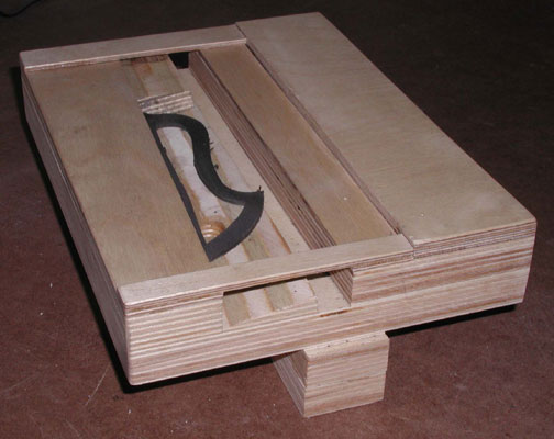

Roy, Sorry it's taken me so long to jump on this thread. You probably have your jig built already. But here is the way I do it. This particular jig is for my old style of bridge but I use the same thing for my new ones.
I hold the bridge in with vacuum. But you could use two of your pin holes and be just as effective. The bridge sits at two angles, one for compensation and the other to lay the saddle back 8•. The small shelf-like slats are stops for the router. It took me awhile to get it set up just right but now slotting a jig is a 20 second job, literally. Hope this helps. Paul

Paul, Thanks for posting. That's something like what I put together originally but my didn't have nearly as much thought put into it. I like it.
